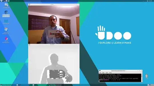

the kinect now is working with the UDOO. I tested it in the UDOO quad. Just follow this steps:
http://www.mariolukas.de/2015/04/proof-of-concept-3d-scanner-with-kinect-and-raspberry-pi2/
RegardsKinect working with the UDOO quad
  • Could you give a brief overview of what you did? This helps prevent link rot and ensures people take the right answer away from this question. – Mark Omo May 08 '15 at 02:14
