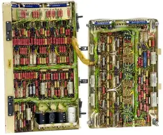

Analog circuits in general are capable of very critical real-time tasks, such as guiding rockets; see -- for example -- the work of Bob Pease. But compare the ease of development by changing a few lines of code to testing and rewiring a system like the Hawk Missile autopilot: Hawk Missile Autopilot
Analog electronics aren't incapable, they're just (in these sorts of cases) impractical.
