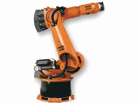

Many large robots include a hydro-pneumatic "spring" at J2 instead of a mass. This has more flexibility than a mess, since the force of this spring can be more easily adjusted (by increasing/decreasing the pressure). Usually this is set up based on the intended load of the robot.
J3 is sometimes co-axial with J2, but this is more common for older robot models or currently for palatalizing robots. enter image description here enter image description here
As for the J3 axis, moving J4-6 behind J3 is currently more popular then moving J3 behind or next to J2. Some manufacturers favour this approach, but even if all 3 motors are placed behind J3 a counterweight might still be needed, as this image shows. The black element behind the 3 motors next to J3 is a counterweight. this counterweight is optional, based on the intended load. (Please also note the hydro-pneumatic spring next to J2).
