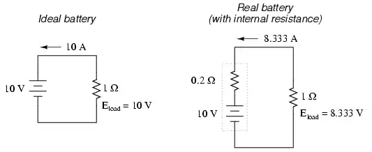

It sounds like you're experiencing a "brown out" caused when the excessive current draw from the battery causes a drop in the supply voltage. This is due to the fact that batteries have internal resistance (a.k.a output impedance).
internal resistance
In this example, if the load drops to $0.2\Omega$, the internal resistance of the battery will cause the output voltage to be divided equally with the external resistance -- the load will only see 5V. It's possible that your 6V supply is dropping to 3V (or less) under load, in much the same way.
A capacitor will delay this effect, but what you really need is a voltage regulator -- many are available in an integrated circuit (IC) package. Some voltage regulators will step up voltage when insufficient, but most simply lower a supply voltage to the voltage needed by a component like your RPi (in which case, your battery voltage would have to be increased so that it never dipped below 5V under full motor load).
Alternatively, you could use a separate battery pack for the RPi. This is a common solution for mobile robots, because it ensures that when the robot is immobilized due to lack of power, radio communication with the onboard PC will not be lost.
