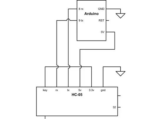

You're getting garbage in because the module is running at 9600 baud. In order for the module to operate at 38400 baud, pin 34 must be set high before the module is powered on. It looks like you are trying to set the pin high in Setup(), but it's already too late by then.
Edit: I see now that he hardwired pin 34 high and he is getting valid data read back from the module. The following fixes still apply if you need a way to ensure the baud rate of the module.
You can fix this in a few ways:
  1. use 9600 baud in your code
  2. wire vcc directly to pin 34 so it's always in 38400 baud mode
  3. change the default uart speed using the AT command that does this (can't remember)
  4. tie the hc-05 reset pin to an Arduino output pin so you can set pin 34 high and then toggle the reset which will ensure the module goes into 38400 mode.

Here is the circuit that goes with the code. The pin labled "Key" is pin 34. Bluetooth command loop schematic
