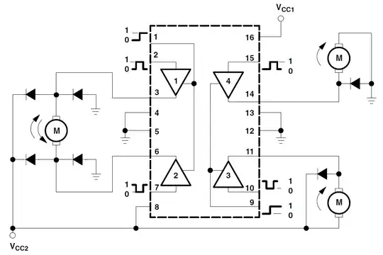

The behaviour you're describing seems to be correct (as described in the Texas Instruments L293 datasheet - which should be the same as ST's variant). Here's an example of how to wire 3 different motors (please note the indicated diodes are internal to the L293).
Copied from TI L293 Datasheet
The idea is that Vcc1 (pin 16) should be associated with your logic inputs: pins 1, 2, 7, 9, 10 and 15 (in other words, if your micro is powered from 3V3, Vcc1 should be 3V3). On the other hand, if you run your motors from 6V, Vcc2 (pin 8) should be 6V (or whichever voltage you use to drive the motors).
For reference, here's the pinout of the TI L293.
