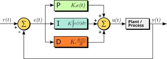

To understand this, take a look at this image, also from the Wikipedia article:
Feedback control loop diagram
The “process gain” is not part of your PID controller. Rather, it is a representation of what is actually happening in your process. Consider a heater control. The signal you are measuring is temperature, but the output of your controller would be something to turn your heater on and off (perhaps a pulse width modulation duty cycle). The “process gain” is simply a mathematical representation of how the actual temperature responds to what your heater is doing.
The article is saying that steady state error gets bigger if the process gain gets bigger, but gets smaller as you turn up the proportional gain in your PID controller.
