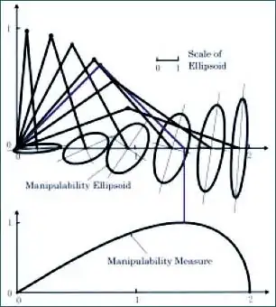

You should read up on "manipulabilty". This is a feature of the arm's configuration. Roughly, it is a measure of how well the arm can move in a particular direction. Usually, this is represented as an ellipse.
The interesting thing about manupulabilty is that there are actually 2, orthogonal ellipoids. One for velocity and one for force. Intuitively, if you think about mechanics, where the arm can move fast, it is not very strong. But where it is strong, it is not very fast. And if you want a very general purpose arm, trying to achieve a more circular ellipse might be desirable.
You may have different link lengths and arm configurations depending on your use case.
There are other measures that you might want to consider too. Such as distance from joint limits, and condition number.
