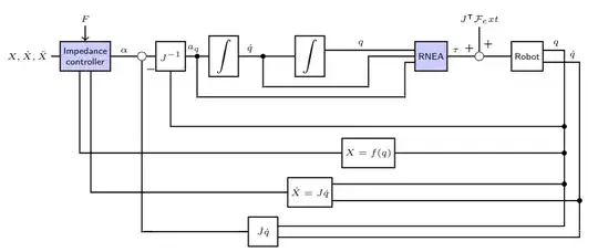

Here is how I see the block diagram of the system (and it might be wrong):
An overview of the system
My question: Where does the force $$F$$
Come into play? Is it the same as:
$$F_{ext} = F$$
If $F_{ext} = F$, does this mean that the Force from the sensor is:
$$\tau = M(q)\ddot{q} + C(q,\dot{q})\dot{q} + G(q) + J^\intercal F ?$$

  • I am not putting this as an answer because I am not certain. But it seems to me that Fext represents the forces applied to the robot by the environment, and F is the set of desired forces the controller should exert on the environment for it to be a true impedance controller. – SteveO Feb 22 '20 at 19:09
  • Hi @SteveO , thank you for responding - just in case for clarity - hopefully you're not taking the block diagram as law, since I was the one that created the diagram. I will edit the post to this to make it clear. But a snippet from (Spong, 2006) states: * "Note that for F = 0 tracking of the reference trajectory, * $x^d (t)$ , is achieved, whereas for nonzero environmental force, tracking is not necessarily achieved." --
    So I suspect that it is a feedback of the external? man - I really don't know.
    – Spaceman Feb 22 '20 at 19:21
  • You may be right. I was using the block diagram. Unfortunately I don’t have Spong’s text to look at the rest of the derivation. But I’ll check some other impedance control literature. – SteveO Feb 22 '20 at 19:29
  • @SteveO Sorry for the late reply, but absolutely - that would be really appreciated :)! – Spaceman Feb 23 '20 at 19:32
Yes, it is the same, $F$ should be the same as $F_{ext}$. And $F$ comes from a sensor or an estimation, in general from a force sensor.
The diagram seems correct and you may have $F$ and $F_{ext}$ coming from the same source.
The impedance controller is an indirect force control, you directly do not control the force exerted to the environment but rather a behavior to an external force based on the position error of the manipulator (mass spring damper system).
A hybrid force/position control where you have a cascaded force control with an impedance control can directly control the force while having a mas spring damper behavior.

  • So $F$ and $F_{ext}$ come from the same source? I suppose the thing I am not understanding is whether I... say, send an external force $F$ to the impedance controller, must I also send $F_{ext}$ at the same time? Since the $J^\intercal F_{ext}$ disturbs the $\tau$ sent to the robot and when I already sent the external force $F$ to the impedance controller. – Spaceman Feb 24 '20 at 11:52
    SInce $F$ in your system will come from a sensor you could add a zero order hold - hold the signal for a sample so that $F$ is delayed one sample with respect to $F_{ext}$, with respect to what you were asking you are cancelling the effect of the external force in the impedance controller the same way you suppress the effects of gravity and coriolis-centrifugal force. – jdios Feb 25 '20 at 12:42
