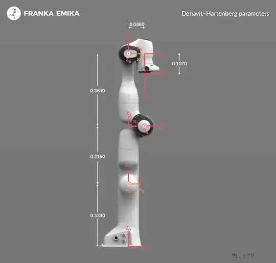

But as of right now I am having difficulty converting from the Modified DH to a Standard DH parameters for the Franka Emika Panda. I need standard because it allows me to avoid recoding a lot of my other functions.
The modified DH parameters are provided in the following link: https://frankaemika.github.io/docs/control_parameters.html#constants

Franka Emika Panda in MDH
I suspect my brain has frozen in favor of idiocy as I tried finding the parameters by doing it by hand, but right now I am consistently getting something that doesn't look right is there someone who can help me out?
