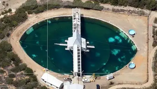

  1. Make the shape of your test tank such that all echoes are reflected into a trap. The TRANSDEC anechoic pool accomplishes this with its eliptical shape; sounds that hit the bottom are directed toward the edge, which has a "trap" around its perimeter. (I can no longer find the cut-away diagram for that... sorry).

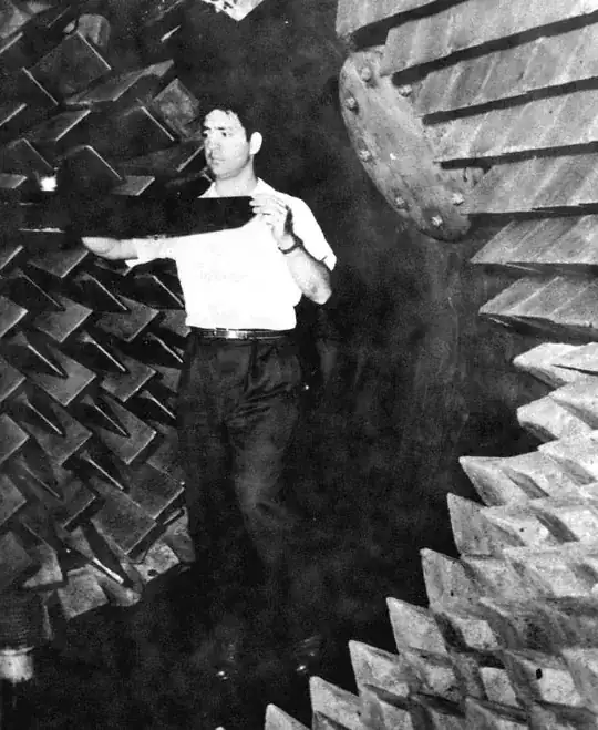

  2. Put foam wedges along the outside of the tank to absorb acoustic energy, similar to the way that recording-studio anechoic chambers are designed. Vincent Benedetti placing a submarine model inside the large anechoic tank at the Naval Research Laboratory - Orlando, Florida.
