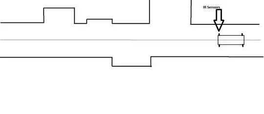

I want to steer a RC car in a straight line.The car has 4 sharp IR sensors on each corner of the car to help it steer the corridor.The corridor is irregular and looks something similar to the picture below.
The car needs to be stay exactly at the middle(shown by lighter line) and take help of the IR sensors to correct its path.
The car has a servo on the front wheel to steer and another that controls the speed.
I tried running it using a algorithm where it summed the values on each side of the car and took the difference.THe difference was then fed to a pid control the output of which went to steer the car.The greater the value from the pid (on either sides), the greater the value of the steering angle till it reaches the middle.
It works for the part where the walls are at similar distance from the center and even then it oscillates a lot around the center and fails miserably around the bumps in the corridor.
I need to make changes to the algorithm and need some help in steering me in the right direction.
The IR sensors are too finicky and is there a way to filter out the noise and make the readings more stable?
Any help regarding the changes that needs to be implemented is much appreciated.
Currently the car only uses 4 IR sensors to guide.I can also use 2 ultrasonic sensors.

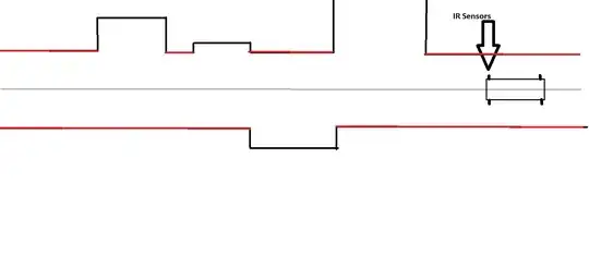

If you have a map, then you can use a Kalman filter with a motion update based on odometry and a sensor update based on the actual IR sensor readings and the expected sensor readings given your current position and the map. The PID control you implemented will only be able to make the vehicle drive in the actual center of the hallway, which would be a curved path based on the bumps in the hallway.
HOWEVER, the simplest things you should try are as follows: 1) Implement an averaging filter on the IR sensor readings...aka take the average of n IR readings as the input to your control algorithm. This simulates a low pass filter and can eliminate high frequency noise. 2) Implement a threshold filter on the IR sensors...if the readings are greater than some range value, then DON'T use that sensor in your control loop. Combined, an averaging filter and threshold filter should mean that your PID loop is only controlling to the center of the walls that you want. In the image below, the algorithm would only control based off readings from the red walls, ignoring any readings from the black walls. If you don't find any walls within your range threshold (i.e. the hallway is open on both sides, you can try just maintaining your current heading).
You could have it keep track of the last distance read from the IR sensors and if it changes more than a certain amount (2%? not sure what would work for you) calculate the difference between the measured distance and the expected distance. Save that difference as an offset, which you apply to the reading from that IR sensor until it returns to normal. If the sensor reads 'infinity' you could ignore the actual reading entirely and just give the PID loop the "expected" value. This is entirely untested.
