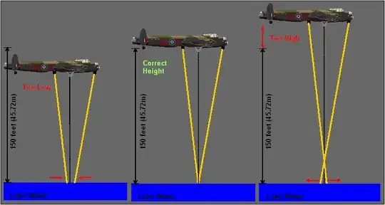

The following diagram (1) illustrates a method by which a Lancaster navigator determined airplane height above the water of a lake. Such a method is useful if the ground lacks features needed for other forms of Visual Servoing. A program I saw about mission Chastise showed one spotlight shining green and the other red, to avoid confusion about which way to go to get to correct altitude. Note, the bomb aiming rangefinder used similar geometric principles.
2-spotlight height-method
With a quadcopter, you could use red and green lasers, eg from a red laser pointer and a green laser pointer. You could also add servos to rotate one or both of the lasers to adjust the altitude setpoint. A camera or a line sensor would detect the relative positions where the lights hit the ground.

    cool... but how does that answer the question about stabilising the quad in the x-y plane? – dm76 Jan 14 '14 at 15:39
    @dm76, my answer was about holding a given altitude, and I didn't have more to say about Visual Servoing than was in the other answers. (This method, like sonar and VS, could be fooled by an object added below the quadcopter.) Note, range finder sights as mentioned in answer might be usable to hold XY position via a camera looking at distant landmarks. – James Waldby - jwpat7 Jan 14 '14 at 16:52
    @jwpat7, "my answer was about holding a given altitude". Indeed, hence my comment since the question was not about holding altitude... – dm76 Jan 15 '14 at 09:39

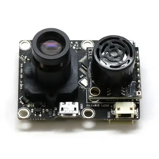

Using a so-called optical flow sensor is the best way to help with holding the horizontal (i.e. in X-Y plane) position. I don't see any reason why you couldn't do the same for vertical control, although a sonar is probably easier and cheaper to use for this (likewise, if you are indoors, you could use 2 sonars for the horizontal position as well)
People used to hack the sensors of optical mice to achieve this:
http://makezine.com/2007/12/15/using-an-optical-mouse-for-rob/ http://areciv.com/index.php?aid=18 http://home.roadrunner.com/~maccody/robotics/croms-1/croms-1.html http://home.roadrunner.com/~maccody/robotics/mouse_hack/mouse_hack.html
Some ready-made sensors are available: http://www.buildyourowndrone.co.uk/Optical-Flow-Sensor-p/op-fs.htm
Some explanation on how to use such device with an Arduino can be found here:https://code.google.com/p/arducopter/wiki/AC2_OptFlow
Nowadays, better sensors are out there (but much more expensive) that works in low-light conditions (i.e. indoors) and are even combined with a sonar (as it makes senses to hold altitude in order to get a better/stable optical reading for XY positioning), such as this one:
px4flow http://store.3drobotics.com/products/px4flow
