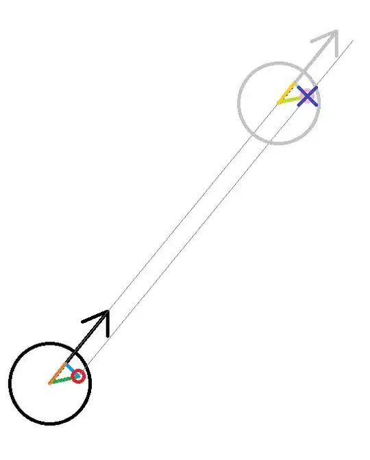

If you want to put the beacon on the target, consider the following graphic:
Starting
The robot faces in some direction and there's a target. In order to get the beacon on the target, you would want to end up like this:
End goal
That is, you want the robot to drive not quite the direct heading to the target. You want to modify the "target" heading by some amount in order to be able to end with the beacon on the target.
Headings described
So, how much do you need to adjust your robot center $M$ to target heading in order to achieve the beacon $A$ to target heading? That depends on how far away the robot center is right now ($r$, the red line) and how far away the beacon is from the robot center ($dy$, in blue, and $dx$, in light orange.)
Distances pictured
So now, if your heading is described as an angle that increases positive CCW from the +x-axis, you can calculate the naive heading (red) as $atan2(\mbox{target}_y - M_y, \mbox{target}_x - M_x)$, and then you can see that the heading offset to get the beacon at the target is $asin(dy/r)$.
Finally, the new distance you need to travel, $dS$, then length of the orange line, is $cos(\theta_{\mbox{heading offset}})*|r| - dx$. The length of $r$, $|r|$, is found with the Pythagorean Theorem $\sqrt{\left(\mbox{target}_x - M_x \right)^2 + \left(\mbox{target}_y - M_y \right)^2}$.

  • I added how I defined point A and to calculate point M isn't hard and it is different to your suggestions because I decided to align the robot with the x-Axis but I currently don't know how to implement the beacon/position update into the code. I get the math behind it but don't know where to put it in the code. I get <Ax,Ay> from my tracking device. I know you wrote how right now but I just dont get it. – Sentrinity Sep 27 '18 at 06:26
  • And I want to reach the goal point so that A = goal point and not that M = goal point. – Sentrinity Sep 27 '18 at 06:44
  • Do I even need the coordinates of M? I just don't know if and how to implement the changes. – Sentrinity Sep 27 '18 at 07:11
  • And how can I determine the right dt I didn't find like a default number for the arduino uno. I just put a number in, which I found in the arduino forum. – Sentrinity Sep 27 '18 at 09:14
  • You need the coordinates of $M$ because it's the center of your robot; if you try to just use $A$ as if it were the center then (1) you won't go straight (from A's perspective) and (2) you won't turn about A, so all your turns are harder to evaluate. If you need a $dT$ value then you should have a static/persistent variable. Call millis or micros to get the current time, subtract the previous time, then set the previous time to the current time. – Chuck Sep 27 '18 at 13:00
  • @Sentrinity - Sorry, please review the update to the answer. – Chuck Sep 28 '18 at 15:31
  • Ty Chuck for the graphic, now I have a better understandig of what I have to do. – Sentrinity Sep 30 '18 at 17:18
  • I can also write dx as Ax-Mx right? – Sentrinity Oct 01 '18 at 08:33
