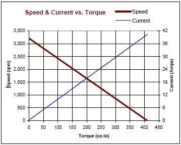

Here is an example torque/speed current for a DC motor:
Torque / Speed Curve for DC motor
Source: societyofrobots.com
So whether or not you can use your H-Bridge depends on how you are using the motor. If you are using the motor at a high speed and thus low torque state, you will not approach the stall current and may stay within the spec for the motor driver.
Furthermore, torque/speed curve is voltage dependent. If you operate at a lower voltage, you will draw less current and could possibly stay within spec for the H-bridge.
