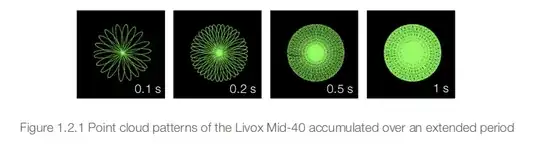

Livox Mid40/Mid-100 ~600 - 1500USD
- Range: 90m
- FoV: 38.4 circular (Mid-40 has a 38.4 circular pattern FoV, so its a bit special, but it can technically be used as a 3D lidar, however the pointcloud pattern is a bit different, the Mid-100 is 3 mid-40 providing up to 100 degree FoV)
- Refresh rate:
- https://store.dji.com/product/livox-mid?vid=48991
A really good review on the Mid-40 can be found here. It also explains some of the challenges with the circular patterns, as some SLAM algorithms and fusing algorithms might needs to be adapted to this new pattern, thus not working out of the box.
