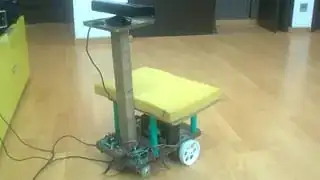

I am in the process of building a mobile autonomous robot which must navigate around an unknown area, must avoid obstacles and receive speech input to do various tasks. It also must recognize faces, objects etc. I am using a Kinect Sensor and wheel odometry data as its sensors. I chose C# as my primary language as the official drivers and sdk are readily available. I have completed the Vision and NLP module and am working on the Navigation part.

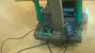

My robot currently uses the Arduino as a module for communication and a Intel i7 x64 bit processor on a laptop as a CPU.
This is the overview of the robot and its electronics:
overview of the robot electronics of the robot

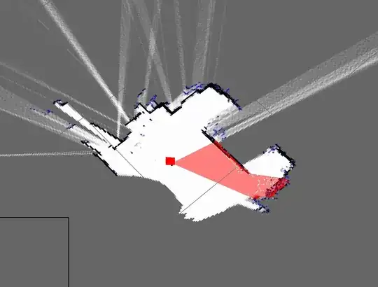

I implemented a simple SLAM algorithm which gets robot position from the encoders and the adds whatever it sees using the kinect (as a 2D slice of the 3D point cloud) to the map.
This is what the maps of my room currently look like:
what a map looks like of my room Another map my room
This is a rough representation of my actual room:
As you can see, they are very different and so really bad maps.
  • Is this expected from using just dead reckoning?
  • I am aware of particle filters that refine it and am ready to implement, but what are the ways in which I can improve this result?

Is this what would be expected: in principle yes. Although you may be able to improve your odometry model, in general it is not enough to get a good map. Without a description of your system its difficult to say how to improve it. On most systems translation estimation is better than rotation. You could add a gyro and measure the rotation. This should improve your results significantly.
Instead of implementing a particle filter yourself, you could use a SLAM implementation e.g. from openslam. This should save you a lot of time, and will most likely give better results.

Because you are using dead reckoning the errors in estimating the pose of the robot accumulate in time. From my experience, after a while, dead reckoning pose estimation becomes useless. If you use extra sensors,like Gyroscope or Accelerometer the pose estimation will improve but since you have no feedback at some point it will diverge as before. As a result, even if you have good data from the Kinect, building an accurate map is difficult since your pose estimation is not valid.
You need to localize your robot at the same time as your try to build your map (SLAM!). So as the map is being created, the same map is also used to localize the robot. This ensures that your pose estimation will not diverge and your map quality should be better. Therefore I would suggest to study some SLAM algorithms (i.e. FastSLAM) and try to implement your own version.
