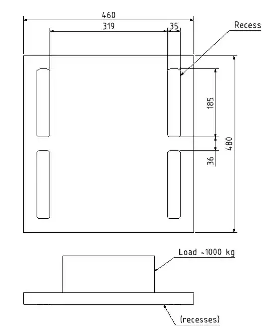

We have an air bearing for a planar xy motion. Today it consists of four pockets according to picture.
Current design
In the current design there are no sealings around the peripheries of the pockets and we suspect that is the reason we get vibrations.
In the current design we control the pressure, same for all for recesses. The flow is adjustable individually for each recess. In practice it is very hard to tune it.
For the non recess surfaces we have used Slydway as we need to be able to operate it without pressure occasionally.

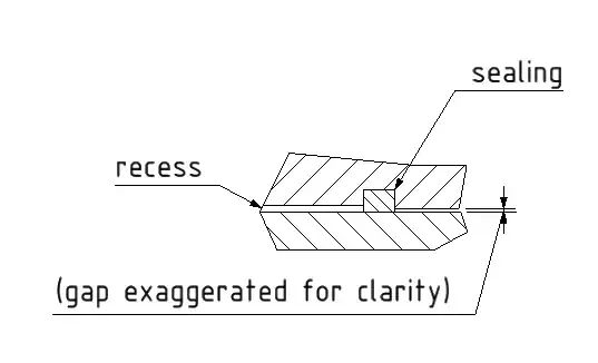

To try to solve the problem we plan to develop a prototype where we can try out the effect of using sealings around the periphery of the pockets. The idea is something like this: Idea for new design
Questions
  • Is the idea with adding sealings good? (sanity check)
  • Suggestions for sealings? (I'm thinking a porous material like felt or cigarette filter)
    Of course all suggestions are welcome.
Edit
I'm going to try and add grooves around the recesses to evaquate the air that leaks. My thinking is that this will give us a more defined area under pressure.

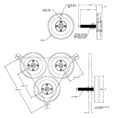

Non of the commercial air bearings I've seen have attempted to seal like this, so I think that your problems with vibration may lie elsewhere.
The problems I have seen with air-bearing systems have been related to mechanical over constraint.

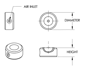

A high performance linear bearing stage I once worked on used six bearings like these:
Copyright of Nelson Air Corp assumed, Image used without permission but with attribution.
Arranged in 3 pairs like this: /\em_
Where /, \ & _ are a pair of bearings (side by side along the track), e was the encoder strip and m was a linear motor.
The problem that we had was that no matter how we tuned the servo loop, if it was tightly tuned enough to get up to the speed and acceleration we needed (3m/s & 2g) then the system would often get into a limit cycle (sometimes erroneously called resonance) when stopping (i.e. it would sit humming).
The way we solved this was to remove one of the air bearings on the / row, relocating it to the middle:
   Front view       Side
Unstable   Stable   view
  o o       o o      |o
   m         m       |m
   e         e       |e
  o o       o o      \o
  o o        o       /o
By removing the excess constraint, we appeared to remove the tendency for a perturbation in one air bearing to affect another bearing and then ripple through to the other bearings.
Depending on your typical direction of motion and the flatness of your surface, you may find that a three point bearing system may work better for your system:

You may also want to consider purchasing commercial air-bearing modules and attaching them to a frame (at least for a prototype) rather than attempting to manufacture your own air bearings. That way you can leverage the knowledge and support provided by the air-bearing manufacturer.

  • +1 three points is an excellent suggestion. We often have tight space constraints so it would be good for us to learn how to make our own. the idea withe the prototype is to give us something to play around with and learn. – Johan Larsson Apr 18 '13 at 11:44
