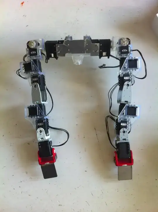

I have developed a 7DOF arm for a humanoid robot (see pic below for more details) I have implemented the IK using a closed form solution and of course I come up with eight solutions - each one is actually positioning the end effector at the right position and orientation (I implemented the method described in the paper: "Kinematics and Inverse Kinematics for the Humanoid Robot HUBO2+"). The question now is how to choose the right one, knowing the fact that the end effector will follow a trajectory. The idea is to compute iteratively the $[N, S, A, P]$ matrix that will be provided to the IK module.
One solution I am thinking off is to choose the joint solution in the decision table that will minimize the given metrics: $$\sum_i (\theta_i^{current} - \theta_i^{next})^2$$ where $\theta_i^{current}$ represents the the current value of the $i^{th}$ joint and $\theta_i^{next}$ is the computed value in the decision table.
Do you think it is the right approach or there are other methods out there to find the best joint solution from the decision table. enter image description here

Yes, if you already have a known pose, choosing a solution that minimizes movement is a decent choice. The obvious draw-back is that which choice is made for a particular pose then depends on history, which may make validation harder.
Another choice would be the one that minimizes the torque (because of gravity/load) on the weaker servos. I notice that you use a MX-28 in the shoulder, but AX-12 in the elbow. With the weight of the gripper and load, and the length of your arms, you should probably not plan on lifting any great weights in that configuration!

  • Hi Jon, thank you for your answer, actually I will make a choice based on the last known pose and the first experiments look good (so far :) ) but may be I missed something regarding the "obvious drawback"? Can you provide more details if you have time? You are right, there is an AX12 in the elbow and I am not planning to lift great weight - it is more about movement and body expression. – fabrice Mar 28 '17 at 09:30
