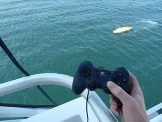

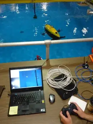

If you can convert the GameCube interface to be a USB game controller, this should go fairly smoothly. I used to buy used USB Xbox and Playstation2 controllers to control our underwater vehicles, and use Python's pygame library for joystick support to read the input from it.
joysticking in the ocean joysticking with live video
Pygame makes it pretty easy. For example, this script to show joystick position.
