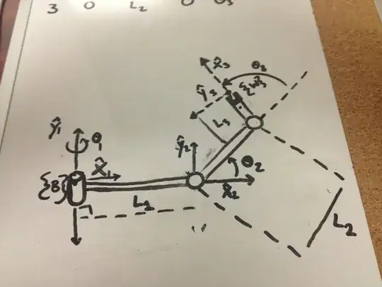

The textbook I'm using doesn't have the answers to the practice questions, so I'm not sure how I'm doing. Are the following DH parameters correct given the frames I assigned?
The original question is as follows: The arm with 3DOF shown below is like the one in example 3.3, except that joint 1's axis is not parallel to the other two. Instead, there is a twist of 90 degrees in magnitude between axes 1 and 2. Derive link parameters and the kinematic equations for $^bT_w$ (where b means base frame and w means wrist frame).
Link Parameters:
$$\begin{array}{ccc} & const. & and & & \\ & angle & distance & & \\ i & \alpha_{i-1} & a_{i-1} & d_i & \bf{\theta_i} \\ \\ 1 & 0 & 0 & 0 & \theta_1 \\ 2 & -90 & L_1 & 0 & \theta_2 \\ 3 & 0 & L_2 & 0 & \theta_3 \\ \end{array}$$
Frame Assignments: Frame Assignments

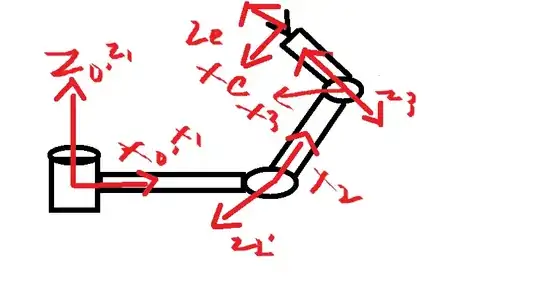

Seems like you are using the Proximal convention. It's always good practice to have an extra frame called {X0,Y0,Z0} at the base. It makes visualizing so much easier. It's your picture modified a bit to make it easy
Anyways, from the image below, I know, it's not good, but hey common, I made it using a mouse. Alright, so I'll Z0 is the base frame and Z1 is parallel to it because, its the rotating Joint1 and Z2 is coming out of the screen, because it is Joint2 and obviously since, Z2 and Z1 are perpendicular to each other X1 will be perpendicular to the plane created by Z1 and Z2. Since, Z2 and Z3 are parallel, X2 will be towards Z3, that is Joint3. Now, Z3 and Ze are perpendicular since, Joint4 is a wrist joint. X3 will be perpendicular to the plane made by Ze and Z3. Finally X4 can be placed arbitrarily but I placed it parallel to X3 since, again, its easier that way. Now shoot off your rules of measuring the DH parameters using the Proximal Convention and boom you are off. :D Have fun..
Tvaṣṭā
  • 421
For the i =2, with alpha(i-1), it should be 0 if Z1 and Z2 are parallel
