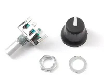

$5 Adafruit 24 Counts Per Revolution Rotary Encoder 24 CPR Rotary Encoder
Cheaper, not quite as much community support in comments.

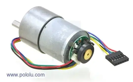

For a little more fun, you can combine the rotary encoder with a gearmotor so you could control the kite string with one piece of equipment.
$40 Pololu 64 Counts Per Revolution Encoder + Gearmotor Pololu Gearmotor with encoder

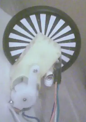

I like @kramer65's answer but because you indicated you might like to make an encoder, I thought I'd share some information on that.
http://www.societyofrobots.com/sensors_encoder.shtml shows a very common way of making a rotary encoder. You attach a disk with evenly spaced holes or reflective surfaces depending on implementation to your shaft. You align a light sensor with the holes and count the number of holes that pass to determine how much the shaft has turned. This has the disadvantage of not being able to determine direction but there was ways to modify the design to add that feature.
An example of a homemade encoder.
More information can be found in these places:
http://groups.csail.mit.edu/mac/users/pmitros/encoder/
http://thedenneys.org/pub/robot/encoders/
