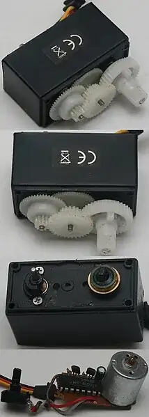

Servo mechanisms are not the "popular" RC-Servos (not-only). Servo is a closed-loop control, not only for motors. Even Steppers could or not be servo-motors. RC-servos are in major cases a DC brushed motor, with reduction gear and a potentiometer for position feedback, and electronic control.
This is a common RC Servo. The fact that it has no ball bearings does not directly to bad precision, there's plenty of high precision products that don't use ball bearings, they are better lubricated and more strong.
RC Servo motor
By Gophi (Own work) [GFDL (http://www.gnu.org/copyleft/fdl.html) or CC BY-SA 4.0-3.0-2.5-2.0-1.0 (http://creativecommons.org/licenses/by-sa/4.0-3.0-2.5-2.0-1.0)], via Wikimedia Commons
So you can use a DC brushed, brush-less, steeper motor, AC induction motor, and still add servo-mechanism (closed loop).
