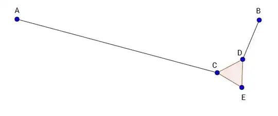

I'm building a modified version of the standard hanging plotter (v-plotter). The basic idea is that you have two cables hanging from stepper motors which form a triangle supporting the pen at the tip.
My design the strings anchored at points $C$ and $D$ which causes the behavior to be somewhat different that the normal plotter, especially when operating close to the motors.
Plotter Diagram
I was able to work out the forward kinematics fairly easily, but the inverse kinematics are turning out to be a real headache. You can see my attempt at a standard geometry solution on math.stackexchange here.
Is there anything specific to calculating kinematics for robotics which could help me?
I'm not interested in modifying the hardware to make the math easier. I'm also not interested in discussing the center of gravity of the pen, cable weight...etc. I want to calculate the kinematics for this as an ideal system.
Any and all advice is appreciated.
Thank you.
Bar Smith
  • 169
  • I doubt that this has a single solution. Unless it's a special edge case, there are infinitely many ways to have two points at a fixed distance to each other with each one of them on its own circle. "discussing the center of gravity of the pen" which you are not interested in, is the important aspect of the problem, which reduces the infinite number of solutions to the purely geometrical problem stated, to a single one of the mechanical/physical problem. Gravity will let the system come to a resting point. The pure mathematical model appears to be insufficient. – Bending Unit 22 Oct 07 '16 at 13:03
  • German Cable Robot including Sourcecode in Forth: VIERTE DIMENSION Das FORTH-Magazin 2 / 2003, page 29 – Manuel Rodriguez Oct 09 '16 at 21:34
6 Answers6
I assume input is the X and Y coordinates of E. In this case, unless you know the orientation also, there is no straightforward way to calculate the coordinates of C and D.
I would write 2 parameterized circle or distance equations around A and B. The $C_x$, $C_y$ and $D_x$ and $D_y$ are unknown. (4 unknowns in this system and 2 equations) Distance from E to D and distance from E to C can be written and so there is a system with 4 equations and 4 unknowns where besides the unknowns all other parameters shoulds be known.
Solve for C and D coordinates and calculate distances to A and B and it is done. I do not think that the equation system will have an explicit solution but a numerical solver (like Newton-Raphson) can be used to solve it iteratively.
Or search for 5 bar linkage inverse kinematics and maybe that will inspire a solution.
50k4
  • 6,652

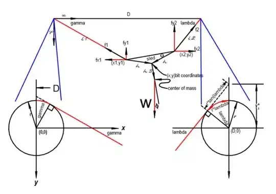

All of the effort and credit for this answer go to Keith Selbo, I am simply reproducing his work here to make the explanation public.
Development of a Method for Translating Hanging Carver (X, Y) Coordinates Into Suspension Lengths That Accounts for Sled Tilt and Finite Radius of the Suspension Anchors
The figure on the next page represents the convex quadrilateral formed by components of a vertical carver; a plotter that suspends a router sled from two points and moves it about the plotting surface by varying the length of the suspension lines. This development encompasses a sled with center of mass not co-located with the plotter bit, causing the sled to adopt a tilt to an angle at which the moment of the sled mass cancels the net moments exerted by the lateral and vertical forces exerted by the sled suspension. Also covered is an offset from the plot origin of the suspension anchor points due to the finite radius of a windlass or sprocket used for pay-out and take-up of the suspension lines as the sled is moved. This offset results in movement of the effective anchor point of the suspension which in turn affects the equilibrium tilt of the sled.
The inputs to the algorithm are the plotter geometry and the x, and y coordinates of the desired bit placement. The output is the length of the left and right suspension lines. It includes the straight portion from the attachment at the sled to the variable tangent on the suspension anchor plus the curved portion of the line from the tangent to the top center of the anchor disk.
The sled tilt angle, and the variable left and right anchor points result in three non-linear equations in three unknowns. The expedient of adding an imaginary extension of the suspension line (see drawing) past the anchor point (tangent) to the y axis allows the use of a pseudo-anchor point that varies only in the y direction which simplifies the equations and the computation. A simple transformation corrects the line length after the solution is obtained. This transformation is included in the final equations for the length of the suspension lines.
There was no obvious closed form solution to the equations, so multi-variate a Newton-Raphson algorithm is used to estimate the three unknowns.
figure
Net Forces:
$$\vec{f}_{y_1} + \vec{f}_{y_2} = -\vec{W}\tag{a}$$ $$\vec{f}_{x_1} + \vec{f}_{x_2} = 0\tag{b}$$
Net Moment:
$$\vec{h_1}\times\vec{f}_{y_1}+\vec{h_2}\times\vec{f}_{y_2} +\vec{h_3}\times\vec{W}=0\tag{c}$$
Definitions:
$$\vert\vec{h_1}\vert = \vert\vec{h_2}\vert = h\tag{d}$$
$$\vert\vec{h_3}\vert = h_3\tag{e}$$
$$\vert\vec{f_{x_1}}\vert = \vert\vec{f_{x_2}}\vert = fx(f)\tag{f}$$
$$\vert\vec{W}\vert = W\tag{g}$$
$$\phi_1 = \theta - \phi, \phi_2 = \theta + \phi \tag{h}$$
Moment Cross Product:
$$\vert\vec{h_3}\vert\vert\vec{W}\vert\sin{\phi}+\vert\vec{f_{x_2}}\vert\vert\vec{h_2}\vert\sin{\phi_2}-\vert\vec{f_{x_1}}\vert\vert h_1\vert\sin{\phi_1}+\vert\vec{f_{y_1}}\vert\vert\vec{h_1}\vert\cos{\phi_1} - \vert\vec{f_{y_2}}\vert\vert\vec{h_2}\vert\cos{\phi_2} = 0\tag{i}$$
Given that:
$$\tan{\gamma} = \frac{y+y_1^+-h\sin{\phi_1}}{x-h\cos{\phi_1}}\tag{j}$$ and:
$$f_{y_1} = fx\tan{\gamma}$$
$$\tan{\gamma} = \frac{y+y_2^+-h\sin{\phi_2}}{D-(x+hcos{\phi_2})}\tag{k}$$
$$fy_2 = fx\tan{\lambda}\tag{l}$$
Combining $(a),(j)$ and $(l)$ yields:
$$W = fx(\tan{\lambda}+\tan{\gamma})\tag{m}$$
$$\frac{W}{tan{\lambda}+tan{\gamma}} = fx\tag{n}$$
Then the net moment is zero when:
$$h_3W\sin{\phi}+ \left\vert\frac{Wh}{\tan{\lambda}+\tan{\gamma}}\right\vert(\sin\phi_2 - \sin\phi_1+\tan\gamma\cos\phi_1 - \tan\lambda\cos\phi_2) = 0 \tag{o}$$
Which simplifies to:
$$f(\phi) = h_3\sin{\phi}+ \left\vert\frac{h}{\tan{\lambda}+\tan{\gamma}}\right\vert(\sin\phi_2 - \sin\phi_1+\tan\gamma\cos\phi_1 - \tan\lambda\cos\phi_2) = 0 \tag{1}$$
From the sprocket detail in the figure we have:
$$y_1^+ = r\sqrt{1+tan^2\gamma}\tag{p}$$
Which yields
$$\tan\gamma = \frac{\sqrt{{(y_1^+)}^2-r^2}}{r} = \frac{y+y_1^+-h\sin\phi_1}{x-h\cos\phi_1}\tag{q}$$
or
$$\frac{\sqrt{{(y_1^+)}^2-r^2}}{r} - \frac{y+y_1^+-h\sin\phi_1}{x-h\cos\phi_1} = 0\tag{2}$$
similarly
$$\frac{\sqrt{(y_2^+)^2-r^2}}{r} - \frac{y+y_2^+-h\sin\phi_2}{D-(x+h\cos\phi_2)} = 0 \tag{3}$$
We now have a nonlinear system F(x), consisting of equations (1), (2), and (3):
$$\begin{bmatrix}f_1(\phi,y_1^+, y_2^+) \\ f_2(\phi, y_1^+, y_2^+) \\ f_3(\phi, y_1^+, y_2^+)\end{bmatrix}$$
Applying the Newton-raphson Method we iteratively solve $J_F(x_n)(\Delta x) = -F(x_n)\tag{r}$ where J is the system Jacobian, x is the vector:
$$\begin{bmatrix}\phi \\ y_1^+ \\ y_2^+\end{bmatrix} and x_{n+1} = x_n+\Delta x \tag{s}$$
Until
$$F(X_n+1) \approx 0 \tag{t}$$
Then:
$$LeftChain = \sqrt{(x-h\cos(\phi_1))^2+(y+y_1^+-h\sin(\phi_1))^2}-r \tan(\gamma)+r\gamma \tag{u}$$ $$RightChain = \sqrt{(D-(x+h\cos(\phi_2)))^2 + (y+y_2^+-h\sin(\phi_2))^2}-r\tan(\lambda)+r\lambda \tag{v}$$
Again, a HUGE thank you to Keith Selbo for this solution.
