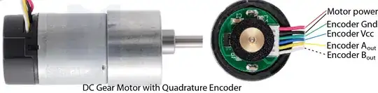

I'm starting out with robotics, got my first DC gear motor with quadrature encoder (https://www.pololu.com/product/2824):
I ultimately plan to hook it up to a motor driver connected to a Tiva Launchpad. However, since I'm a noob, and curious, I am starting by just playing with it with my breadboard, oscilloscope, and voltage source. E.g., when I plug in the motor power lines into my (variable) voltage source the axis spins nicely as expected between 1 and 12 V.
The problems start when I try to check how the encoder works. To do this, first I plug a a 5V source into the encoder GND/Vcc, and then try to monitor the encoder output.
While the motor is running, I check the Yellow (encoder A output) cable (referencing it to the green (encoder GND) cable). I made a video that shows a representative output from one of the lines (no USB on my old oscilloscope so I took a video of it using my phone).
As you would see at the video, the output doesn't look anything like the beautiful square waves you typically see in the documentation. Instead, it is an extremely degraded noisy sin wave (at the correct frequency for the encoder). The amplitude of the sin is not constant, but changes drastically over time. Strangely, sometimes it "locks in" and looks like the ideal square wave, for about a second or two, but then it gets all wonky again.
Both of the lines (encoder A and B output) act this way, and they act this way at the same time (e.g., they will both lock in and square up at the same time, for those brief glorious moments of clarity). Both of my motors are the same, so I don't think it's that I have a bad motor.
I have also checked using Vcc=12V, but it made no difference other than changing the amplitude of the output.

    Are you just connecting the "Encoder A Output" (for example) directly to the Oscilloscope input? If so I would suggest also adding a pull-up resistor (maybe 5k or 10k ohms) from each output to "Encoder Vcc". This might be necessary to get the proper output from the encoders, if they are Hall-effect types. – Andy Aug 30 '16 at 06:24
    If you look at the encoder board on the motor, you will see it already has pull up resistors and even some filtering caps. I would suggest fiddling a little with a sensor. Try to bend it towards the magnet and see if it helps. – mactro Aug 30 '16 at 08:50
  • After resetting everything, it worked for about 10 minutes last night: 5V square waves from both outputs, out of phase. Then I fiddled with it (I unplugged one of the grounds to see what would happen), and it is fubar again: saggy little 50mV waves completely in phase and don't change with rotation speed of motor (yes, I plugged the ground back in). Already did re-check in second motor, is acting the same. Not sure how to fiddle with sensor, and my experience last night suggests it isn't that, no? Maybe my wire isn't fitting snugly in breadboard, will get lower-gauge, and reset everything. – neuronet Aug 30 '16 at 13:16
  • @neurone - yes, it sounds like you just have a dodgy connection somewhere in the setup. (Maybe either the pullup resistors or one of the 0V connections.) At least you know now the encoders are definitely OK. The waves you're seeing may be noise, completely unrelated to the encoder signal... – Andy Aug 30 '16 at 13:29
    Oh crap I reversed Encoder Vcc/Encoder Ground last night when I "fiddled with it". And that's when it stopped working. Seems to be close now. Oh, and one of my connections was fubar in my breadboard so I was only getting ~50 mV through from 5V. Not sure how that is possible...but I checked and there it was. Dear lord I am such a noob (if you can't tell...programmer here, not hardware guy). – neuronet Aug 30 '16 at 13:29
    Umm, while I hate to admit this, I have to do it. I haven't done electronics in a few years, and never did it much. I forgot the top/bottom power rails on a breadboard are separate. There was no bad connection on my breadboard. I was a freaking idiot (Napolean Dynamite voice). – neuronet Aug 30 '16 at 13:46
    Thank you for updating - it's always good for the rest of us to know where the missing link was! – Andy Aug 30 '16 at 14:04
