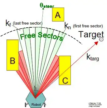

I think that vector field histogram method should be a good solution here. It's a method of local motion planning (avoiding local obstacles while navigating to a global target). It involves mapping measurements into cartesian occupancy grid, and making a polar obstacle density histogram from that grid. Later the direction with lowest obstacle density and closest to the desired target is selected. enter image description here
