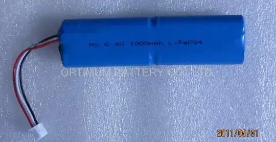

It sounds like you're planning to create a 2×2 configuration of individual cells, which is a common configuration: 4 pack 6.4V lithium battery
(source: diytrade.com)
The 6.4V charger is designed for a pair of 3.2V cells in series, so you should be able to add as many parallel stacks of these as you like. They will simply take longer to charge.

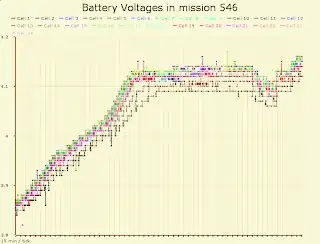

As you can see, they mostly discharge and charge together -- you can see the point at which we plugged in the charger. A few testing days later, one of the cells began drifting apart:

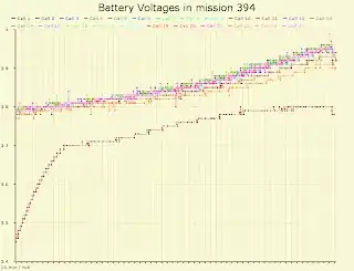

Eventually, they look like this (what it looked like before servicing):

The moral of the story is that using many cells in series doesn't guarantee even charging, because each cell has a slightly different capacity. Using cells in parallel is better because it keeps their voltages equal.
For your particular case: if you don't charge all 4 cells in parallel, make sure that you monitor the voltage of each set of cells in the series -- one parallel pair will have a higher voltage than the other parallel pair. Don't discharge them below the minimum rated voltage of the low pair, and don't charge them above the maximum rated voltage of the higher pair. The difference in voltage between the two sets of cells will impact your available operating time, so it will make sense to manually balance the voltages (using 3.2V parallel charging) every so often.
