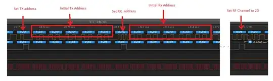

On the Config phase, some registers are being set, like the pipe number for Rx and the address, RF channel and more. Here is part of the config capture: config phase
So the initial Tx (and Rx) address is 5 bytes: 0xCCCCCCCCCC. And the initial RF Channel is 0x2D. The default address length for the two chips is 5 bytes and since the remote control does not change it, the length should stay 5 bytes.

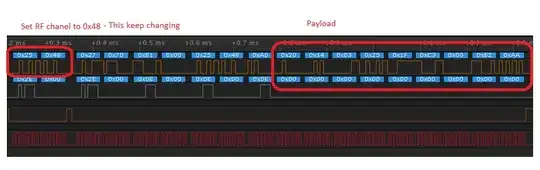

Then comes the search phase. In that phase, the remote sends basically the same data over and over, and only changes the RF channel. Here is the last search packet:
Search stage
So after many transmissions with different RF channels, something weird happens. The remote hits the correct RF channel for the quadcopter, but I can't figure out how he understands that, since the Status register (on the MISO channel) stays the same on the last search packets. Here is where the remote control MCU tells the BK2423 to change the RF Channel, with no evidence to anything else around:

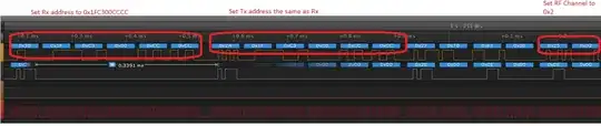

Then the MCU tells the BK2423 to change the address and RF channel to the right ones. It must be the right ones since the quadcopter reacts properly:
Changing address and RF channel again
From this point and on, the remote control sends command packets and the quadcopter happily fly around. I couldn't manage to properly pass the search phase.
