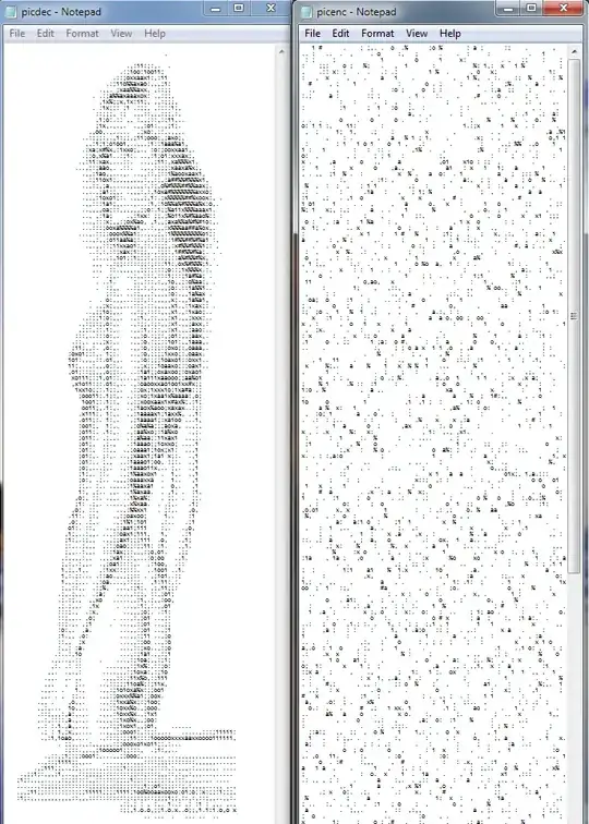

Here an example of how to use it and how output looks:
// [encode] + save to file for output comparison
// AnsiString s holds oll my texts (an image in this case)
Randomize();
ofs_init();
for (i=0;i<s.Length();i++) ofs_write(i,s[i+1]);
i=FileCreate("picenc.txt"); FileWrite(i,txt,N); FileClose(i);
// [decode] you should not decode critical strings to memory rather decode each char only when needed instead
// I decode the whole thing to save to file for output comparison
for (i=0;i<s.Length();i++) s[i+1]=ofs_read(i);
i=FileCreate("picdec.txt"); FileWrite(i,s.c_str(),s.Length()); FileClose(i);
And the results are like this:
output
On the left is decoded text picdec.txt and on the right is encoded text picenc.txt this is how the strings looks in memory.
On top of this you can add any kind of encryption (not only to text itself but to offset table also ...)
