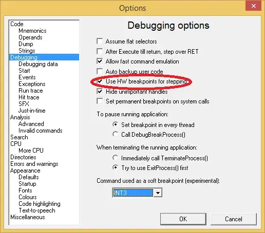

What are the debug registers
The technical meaning of this warning is simply that Olly noticed the program you're debugging changed the CPU's debug registers. These registers are available to facilitate CPU-enabled debugging. The original use case is speeding up debugging efforts by using these CPU specific features.
There are some broad advantages for using the debug registers by debuggers in general and for anti-analysis executables in particular.
  1. More efficient/fast debugging experience.
  2. Faster debugged made timing-based anti-debugging harder by drastically shortening the time certain debugging tasks take to complete.
  3. Hardware assisted breakpoints and debugging features are harder to bypass or detect, and got less attention since most reversing related debuggers did not use them in the past.
bullets 2 and 3 might seem the same, but although achieving a similar goal the cause is completely different.
Difference between Ollydbg1 and 2
Olly v2 started using debug registers by default for it's own debugging efforts. This wasn't too common for anti-analysis specific debuggers such as olly previously, which proved quite helpful at the begining and was a decent idea. It's important to note olly1 exposed debug register usage, but it had less of a focus and wasn't the default behavior.
This can be turned off by un-checking this checkbox: Ollydbg configuration
