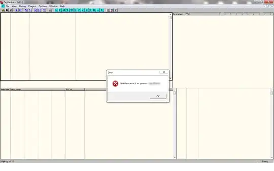

I have a target application protected with CrypKey. When i try to attach to the apps in OllyDbg and Ida Pro i receive Unable to attach to this process.
The bad news is that i want to unpack the main exe after executing of Crypkey loader but after patching main exe and loader to obtain an infinite loop at the end of the code of the loader i am unable to attach to main exe and reach the OEP.
Do you know how or why i am unable to attack? A good solution in this cases?
Thank you very much
See image below:

  • The main exe run the loader code that debub the main exe as ring 3 debugger so CreateProcess will be called to instantiate the loader and not the main exe. i am able to debug loader and see the int 3 opcode replaced at runtime in the main exe. At the end of this process i need to return to main exe and continue debugging to reach the OEP. I am unable to do it because the main exe refuse to be attached as process from any debugger. I hope that now the scenario it's more clear. – itseeder Oct 11 '14 at 18:49
  • @Seed3Key So essentially you mean that the main exe spawns the loader process & the main exe cannot be debugged. If such is the case check whether you can attach to the main process before the loader process is created. If you cannot, then the main exe may well be debugging itself. – 0xec Oct 11 '14 at 19:09
Use a anti-anti-debug plugin that supports "kill anti-attach" like ScyllaHide
