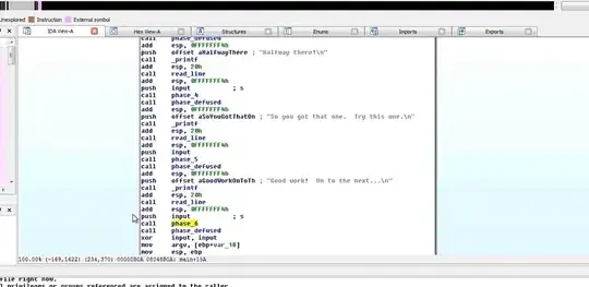

Using Fentanyl is GUI-driven, but it works pretty well and even nop-pads your instructions and fixes offsets.
Fentanyl demo
