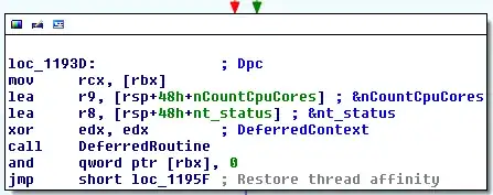

5. Then for our thread running in core 0, execute DPC routine DeferredRoutine:

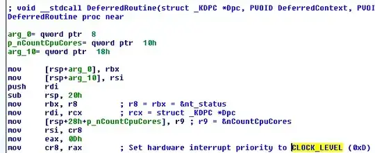

Now the interesting thing is what happens in DeferredRoutine:
(Note that this routine will be executed on each CPU core.)
A. The first step, set IRQL for the thread to CLOCK_LEVEL (or 13 for x64 code.) This is done by using the cr8 CPU register. Doing this will block processing of the most interrupts:
