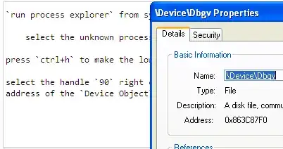

Now run Process Explorer from SysInternals. Select the unknown process, and press Ctrl+H to make the lower pane show handles.
Select the handle 90, right click and select properties. Process Explorer will show the address of the Device Object as noted by Ollydbg. This device object is a File Object:
ollydbg 2.01 can show memory above 0x7fffffff (kernel mode memory) we will use that feature to find the driver associated with this device
Read about the FILE_OBJECT structure relevant to your OS. In Windows XP you will find the address of device object at +4 from file object.
Select the dump window press Ctrl+G and type in the address process explorer showed viz
863c87f0 and follow expression

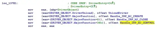

More specifically, it sounds like your executable is loading a Device Driver. Userspace executables often communicates with drivers via IOCTLs (or I/O Controls).
DeviceIoControl does just that: sends an IOCTL to the driver. Note the second parameter to this function: DWORD dwIoControlCode. This is the code that identifies which IOCTL the program is requesting the driver to perform. It is just a 32-bit DWORD value.
Now, on the driver side there are a few things you need to know. (Be prepared to swim through a few structures!)
When a driver is first loaded, its DriverEntry function will be called. This is passed a pointer to the driver's DRIVER_OBJECT. In this structure there is an array named MajorFunction, which is a set of function pointers that the kernel will call when userspace tries to do something with the driver (e.g. Open, Close, or send IOCTL). These functions are identified by IRP Major Function Codes.
In the case of ioctls sent by DeviceIoControl, the IRP_MJ_DEVICE_CONTROL function is called. This function is called for any ioctl. Now to determine which dwIoControlCode was passed to DeviceIoControl, the ioctl-handling function will look at Parameters.DeviceIoControl.IoControlCode.
From this value, there is often a switch-statement which selects different behavior depending on the control code.
So first, you want to load up the .sys driver into IDA. The function that IDA marks as DriverEntry is really a wrapper generated by the DDK. The real DriverEntry is usually jmp'd to at the end of this stub.
In the real DriverEntry, you'll want to locate where the MajorFunction entries are populated. It might look something like this:
