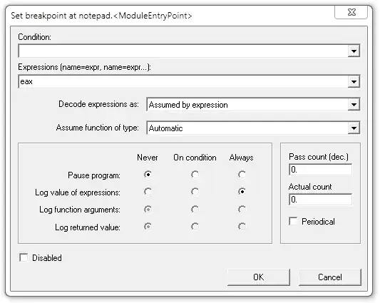

Select the MOV EDI, EAX instruction and press Shift+F4 to open the Conditional log breakpoint window.
In that window, specify eax as the expression, set Pause program to Never, and set Log value of expressions to Always:
Press the OK button, run your program, and now the referenced string will get logged to OllyDbg's log window whenever that instruction is hit.
