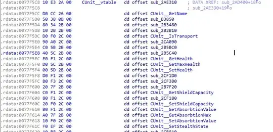

Is there a way to convert a .rdata vtable entry to an IDA struct? An example of the vtable entry:
And what the resulting struct should look like (but with all entries - this vtable specifically, should have 109 vfuncs):
I would assume there's some option to give IDA an address, and vtable length, I think I am just missing it. Or maybe there's a script I don't know of, which does this?
I'm using IDA v6.1.
