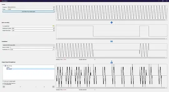

  • Using the generator tab to generate a new refined signal like so:enter image description here

Edit (4): I just realized I can use the Generator tab... enter image description here
Will test tomorrow and update accordingly!

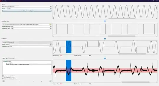

Edit (6): Setting the sample rate to 4M and bandwidth to 2M during recording yielded the following: enter image description here Autodetect seems to have gotten the right values, samples per symbol was manually set to 4000 since that is the approximate width of a symbol:
Simply replaying the signal didn't work, but generating a new signal from the Generator tab with autodetect parameters DID ! enter image description here
