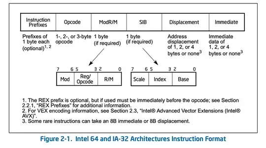

I see this image too, but don't know what to do with it entirely yet.
How do you write these 4 example x86 assembly instructions in opcodes, according to the Intel docs? How do I interpret the "operand encoding" values in the table above? Say we select some random registers or slots of memory that fit the instruction type constraints above, then how do you figure out how to write it down into hex code using the Intel Manuals?
