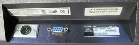

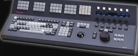

Suppose you've never done reverse engineering before (apart from taking apart already-broken tape recorders). Also suppose you had a machine as pictured below, with a serial-looking and another multi-pin connector on the back. Thirdly, suppose you wanted to use this console as a computer input, hoping to gain control of more than just the keyboard part (it's got a trackball, a hefty jog/cue wheel, rotary dials, blinkenlights, and a two-line character VFD display).
Lastly, suppose you don't have access to any technical specifications! No user manual, no installation guide, no service manual, not even a crappy nth-generation photocopy of the pin-outs. The company no longer exists, and the archive of their web site is of no help. Pretty much all I have is that this console runs on "90-264V" and draws "<42W".

I am confident that I could surely figure out the main power pins based on the red and black wires going to that Molex connector ... but the rest of those pins? All that functionality? I don't even know where to start.

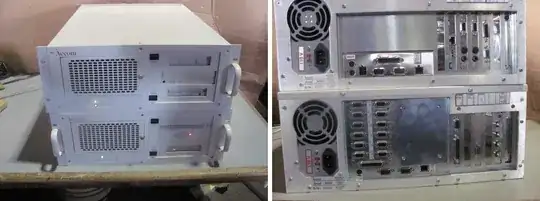

EDIT: By the way, these are the chassis: The Display chassis on top of the Comms chassis (neither of which I have, or plan to acquire).
Display and Comms chassis

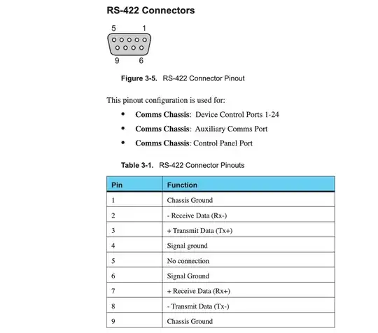

Here's a manual which talks about the Axial MX from Accom ~2005. If it's a series of edit controllers, they'll likely work the same under the hood and use the same protocol from one version to the next.
Ports
Looks like an RS422 Serial. So you just need to hook it up to a computer with a serial port and take a look at what data is transmitted when you hit a key. You'll have to figure out some of the serial port parameters such as rate, parity, etc, but this should get you going.
