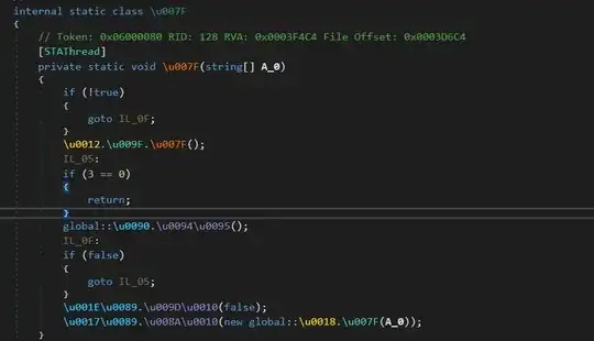

Opening the file in dnspy but the code wasn't readable, especially the methods and the functions name are in unicode form.

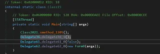

  2. Tried a modded version of de4dot, and I was able to deobfustacte the exe,but all functions shown as "delegate". The exe file was detected as "Unkown Obfustactor" as well, but managed to cleaned it. enter image description here
  3. Tried to debug the cleaned verison but when I start dnspy I get an exception (System.NullReferenceException) enter image description here

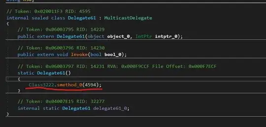

While looking through the code, I found that all "delegate" calls are referred to a function which takes an intger but I couldn't find any obvious return from this function, what I do think it returns the function and method name but... HOW!! enter image description here

  • I do not know which one specifically, but perhaps one of the deobfuscators aside from de4dot can help? - https://github.com/NotPrab/.NET-Deobfuscator – Col-E Aug 20 '20 at 05:49
  • Thanks, but still I haven't accomplished anything with the list, but it's a really good list to keep.. I appreciate it. – mo5br Aug 20 '20 at 20:15
  • I have the same problem, I have tried many tools, but after deobfuscation, the program doesn't work – mike bria Dec 01 '21 at 07:50
    Can you take a TTD trace of the app launching? https://docs.microsoft.com/en-us/windows-hardware/drivers/debugger/time-travel-debugging-overview This could be used to analyze what is going on, but it may or may not work, and needs some familiarity with windbg and the sos/sosex extensions to use effectively – chentiangemalc Apr 27 '22 at 07:51
  • This looks like a crypto obfuscator assembly, get in touch with me and i might be able to run a tool i developed to deob this kind of obfuscated code. – Mastercodeon Apr 27 '22 at 07:36
