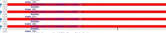

You will see 'MainWindow::qt_metacast' method but you need 'MainWindow::qt_metacall' now. Inside of the 'MainWindow::qt_metacall' you will see 'MainWindow::qt_static_metacall' call. Inside it will be a big switch with real slots called when buttons are clicked (more generally: not only buttons and not only clicks).
Inside of the MainWindow::qt_static_metacall

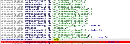

As it's easy to notice, the necessary names already have the correct names, but in the more complicated case, when the binary is stripped, it will be necessary to restore the names from the table of method names. The number in the switch corresponds to the row index with the method name in the method table with some exceptions (refer to the Qt5 sources please)
An example of some additional strings located in the same table of methods that are not slots:
