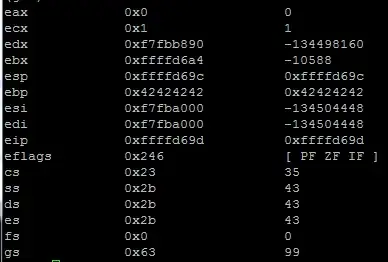

Here is the assembly view of shellcode (after returning to overwritten address). I step instructions one by one up to mov %esp, %ecx(0xffffd69d)
And then when i try to execute mov %esp, %ecx it goes one byte too close. EIP should point 0xffffd69f but it doesn't.

EDIT: Had to update all pictures, Registers dump before 'mov %esp,%ecx'
