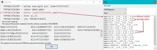

Fall damage causes the movss [rbx+00000164],xmm0 to fire, xmm0 represents the amount of health subtracted from the damage of falling.
Then it sends xmm0 to rbx+000000164.
That causes the health to go down. I want it to go Up, or not lose/gain any at all.
I tried seeing if there were any xmm#s in the scanner that lined up with max health (100) to see if I could just send the player's max health every time they took damage (This would solve it easily)
However, it doesnt have it. As seen here: enter image description here
