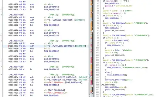

After successfully extracting a Bluetooth door lock's firmware from a nRF51, I proceeded to decompile it using Ghidra. My aim is to able to read some of its original source code, even though I understand it won't be as clean as the original.
But, after analyzing the bin file, I get tons of error. Architecture used/tried to solve this issue was both the ARM Cortex LE 32 bit and the ARM v6 LE 32 bit. Looked for solutions on the internet and I did not find anyone with the same issue. All of the errors are Bad Instruction.
Here's pictures of two different analyze:
Without ARM Aggressive Instruction Finder (Prototype) enter image description here
With ARM Aggressive Instruction Finder (Prototype) enter image description here
The reason I posted two pictures of my code browser because those two different analysis gave me different amount of bookmark. I know it's because of the Instruction Finder but who knows this might help you to help me.

The firmware is incorrectly dumped. In your file all occurrences of the byte 0A have been replaced with 0D 0A. Looks like a line ending issue. May be the tool which you have used to dump the firmware have prepended a 0D to each 0A.
After replacing all instances of 0D 0A with 0A, it has an exact size of 256 KiB (262144 bytes) as it should be. Previously it had a size of 263788 bytes ~ 257.6 KiB.
For reference, I've uploaded the fixed firmware here

Loading the binary in Ghidra using the language ARM-Cortex-32-little, the code is readable.
There are still some errors but those are because I have not created the memory segments. For more information look into the nRF51 Series Reference Manual, Section - 5.
