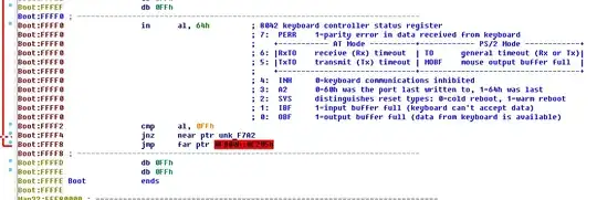

I've loaded flash chip image into IDA, looked up chipset datasheet (which, BTW, I found incredibly unclear on the topic of BIOS memory mapping) and corrected flash chip addresses accordingly, i.e. copied upper 128K of BIOS ROM to 0xE0000 to 0xFFFFF 16-bit analysis section, and also copied everything that fits to High-BIOS area FFE0_0000h-FFFF_FFFFh (32-bit analysis section, because of 32-bit address). Then started analysis at 0xFFFF0 (x86 reset vector, 16-bit real mode). Processor setting is P6 (as far as I can tell Dothan family is based on P6 arch) And this is what I get (note that F7A1 and the pointer in red both lead to memory which is not mapped to BIOS ROM, at least as far as I can tell from the datasheet): IDA disassembly
Obviously, 32-bit analysis (at FFFF_FFF0) of the first 16 bytes executed makes no sense too, since the processor starts up in real mode.
Keyboard controller access (first check if it's busy, then enable A20 - standard x86 thing) tells me that I was probably right with reset vector memory mapping.

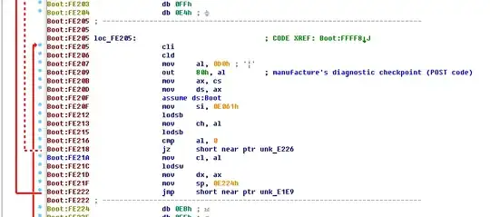

EDIT: The pointer in red actually leads to a location mapped to BIOS ROM, my bad. Here is where the control jumps: IDA disassembly2 We've found POSTcode D0, that's great. But here all jumps lead to some low addresses, which are not mapped to BIOS ROM. Same problem repeats.
You need to load the last 64KB of the ROM at linear address 0xF0000 (0xF000:0000) and create there a 16-bit segment with the base 0xF000. Then all your “low addresses” will line up (they point into the current segment with CS=0xF000).
In case you get references to E000, load the second 64KB chunk and so on.
Once you get to 32-bit code, it will likely be using 32-bit addressing with the end of the ROM at FFFFFFFF, so load and create 32-bit segments accordingly.

Your disassembly doesn't show enough memory to know if the target is empty memory, but the x86 segmentation model means that the jump target for 0xF000:E205 is 0xFE205 (i.e. the (0xF000 << 4) + the 0xE205). IDA doesn't show that in an obvious way by default.

    Oh... My bad. I just assumed that it's red color and the fact that jump on double click mean it's invalid jump for my disassembly and overlooked that it's 0xFE205! Of course it is mapped to BIOS ROM then. BTW, how do I make IDA use linear addressing for such pointers? Segmented addresses always confuse me... – kutukvpavel Jan 24 '20 at 21:28
  • But the first part of the question remains valid. Why on earth is there a jump to 0xF7A2? And why does it compare keyboard control register against 0xFF and does not check the busy bit specifically? As far as I understand, jmp to the main code gets executed only if al is equal to FFh. – kutukvpavel Jan 24 '20 at 21:32
  • In order to answer why it goes there, you'd have to show a disassembly of 0xFF7A2. It's within the same 0xF000 segment as the rest of that code (which is why the first 0xF is missing), so it's likely a valid address. – peter ferrie Jan 27 '20 at 23:05
