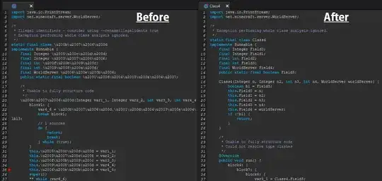

Before tossing this at a decompiler you should use automated tools like java-deobfuscator to clean up the illegal names and remove some of the control-flow obfuscation.
This can be accomplished with this config (Assuming you have a bukkit jar handy):
input: unnamedObf.jar
output: unnamedObf-clean.jar
path: [rt.jar, bukkit.jar]
transformers:
  - com.javadeobfuscator.deobfuscator.transformers.general.removers.IllegalSignatureRemover
  - com.javadeobfuscator.deobfuscator.transformers.general.removers.LineNumberRemover
  - com.javadeobfuscator.deobfuscator.transformers.general.removers.LocalVariableRemover
  - com.javadeobfuscator.deobfuscator.transformers.general.removers.SyntheticBridgeRemover
  - com.javadeobfuscator.deobfuscator.transformers.normalizer.PackageNormalizer
  - com.javadeobfuscator.deobfuscator.transformers.normalizer.ClassNormalizer
  - com.javadeobfuscator.deobfuscator.transformers.normalizer.FieldNormalizer
  - com.javadeobfuscator.deobfuscator.transformers.normalizer.MethodNormalizer
  - com.javadeobfuscator.deobfuscator.transformers.general.peephole.PeepholeOptimizer
Here's a comparsion for before & after using CFR. decompile comparison before and after applying java-deobfuscator
It doesn't clear everything up, there's still plenty of obfuscator-generated invoke-dynamic calls and opaque predicates, but its definitely a better starting point than the original jar.
