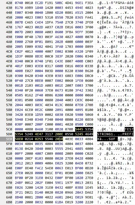

http://s000.tinyupload.com/index.php?file_id=08960658549599455274 contains a sample file. The string "TESTSTRING1" and "PREFIXTESTSTRING1SUFFIX" are contained in the uncompressed stream.
Shannon entropy is 5.84154 for the data chunk which is somewhere in the middle between english text and encrypted.
Here is an example which should demonstrate how the lenght field is computed: The string "TESTSTRING123" precedes the string "PREFIX...SUFFIX".
                             P  R  E  F  I  X  L1 L2 D     S  U  F  L1 D
PREFIXTESTSTRING123SUFFIX 05 50 52 45 46 49 58 E0 04 16 02 53 55 46 20 12 40 42 00
PREFIXTESTSTRING12SUFFIX  05 50 52 45 46 49 58 E0 03 16 02 53 55 46 20 11 40 41 00
PREFIXTESTSTRING1SUFFIX   05 50 52 45 46 49 58 E0 02 16 02 53 55 46 20 10 40 40 00 33 40
PREFIXTESTSTRINGSUFFIX    05 50 52 45 46 49 58 E0 01 16 02 53 55 46 20 0F 40 3F 00 33 40
PREFIXTESTSTRINSUFFIX     05 50 52 45 46 49 58 E0 00 16 02 53 55 46 20 0E 40 3E 00 33 40

Edit The whole file from offset 00000410 onwards appears to be decompressible using the above encoding scheme. Doing so gives me the below. You can see that the end of my first excerpt has a number of 32 bit floating point values. The 2nd excerpt has your test string.

00000430:  00 00 00 00 00 01 00 00 00 07 00 00 00 00 00 00  ................
00000440:  00 00 00 00 00 01 01 00 00 00 00 C0 00 00 00 40  ...............@
00000450:  01 01 00 00 00 00 00 01 00 00 00 0B 00 00 00 54  ...............T
00000460:  45 53 54 53 54 52 49 4E 47 31 17 00 00 00 50 52  ESTSTRING1....PR
00000470:  45 46 49 58 54 45 53 54 53 54 52 49 4E 47 31 53  EFIXTESTSTRING1S
00000480:  55 46 46 49 58 01 00 00 00 33 01 00 00 00 34 01  UFFIX....3....4.
00000490:  00 00 00 35 01 00 00 00 36 01 00 00 00 37 01 00  ...5....6....7..
000004A0:  00 00 38 04 00 00 00 00 00 00 00 55 55 29 41 02  ..8........UU)A.
