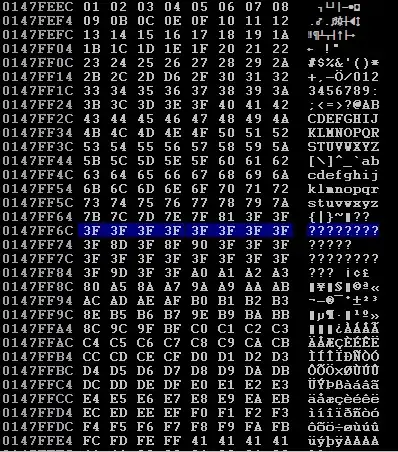

I am facing problem in finding bad characters because the hex codes are being replaced with \x3F & some other codes.
Here I have all the 256 hex chars from \x01 to \xFF and as you can see many of the hex char is being replaced with \x3F and other chars and hence I am not able to figure out the bad chars.
I tried to figure out the bad chars & the chars which are being replaced, which are:
\x00\x0a\x0d\x80\x82\x83\x84\x85\x86\x87\x88\x89\x8a\x8b\x8c\x8e\x91\x92\x93\x94\x95\x95\x97\x98\x99\x9a\x9b\x9c\x9e\x9f\xa4\xa6\xa8\xb4\xb8\xbc\xbd\xbe

The input string is probably decoded as UTF-8 string. The '?' appears because the encoding is invalid. The easiest way to preserve the shellcode is probably use an ASCII encoder, since UTF-8 is backward compatible with ASCII.

  • Hey, the issue was there because I was creating the shellcode on my linux vm and then I was copying it to windows7 vm to excute it. May be the encoding on windows was differerent from linux and some characters were not recognized. When I created the shellcode on the same windows machine it loaded properly in the memory. By the way what encoding differences would be there if we copy some data from linux to windows? – Mukesh Sep 13 '19 at 13:57
  • You need to provide more details to have an answer, e.g. how you load the payload, what's the target, etc. But, basically, if you copy the payload from your Linux (vm) to Windows as hex char (i.e. \xNN\xNN\xNN\xNN...), the encoding won't change. So far, I have the impression the target application decodes your payload as an UTF-8 string. – wisk Sep 16 '19 at 03:24
I would try to go with a trial&error approach. Seems the restricted chars are inside the range from 0x80 to 0xa9 with some exclusions. If you're developing an exploit and you haven't got time to figure it out try to suppose these as bad chars and avoid their use with msfvenom encoding.
If you have time, try to use a buffer like 0x41 0x41 0x41 0xbadchar 0x41 ... 0x41 proceeding one by one, in the end, you will figure it out precisely.
