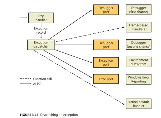

I think I have finally found an answer to this question. Since I didn't find an answer anywhere in the Internet (including MSDN documentation for signal, articles covering anti debuggging techniques and exception handling on Windows) and the problem existed in all debuggers tested (OllyDbg1/2, x64dbg, IDA debugger, radare2, gdb), I analysed exception handling mechanism described in Windows Internals 6th edition. Following image and cites come from this book, from page 126.
The exception dispatching process may be illustrated this way (actions will be performed from top to the bottom on the image): exception dispatching
Actions performed:
  1. the first action the exception dispatcher takes is to see whether the process that incurred the exception has an associated debugger process. If it does, the exception dispatcher sends a debugger object message to the debug object associated with the process (which internally the system refers to as a “port” for compatibility with programs that might rely on behavior in Windows 2000, which used an LPC port instead of a debug object).
  2. If the process has no debugger process attached or if the debugger doesn’t handle the exception, the exception dispatcher switches into user mode, copies the trap frame to the user stack formatted as a CONTEXT data structure [...], and calls a routine to find a structured or vectored exception handler
  3. If none is found or if none handles the exception, the exception dispatcher switches back into kernel mode and calls the debugger again to allow the user to do more debugging. (This is called the second-chance notification.)
  4. If the debugger isn’t running and no user-mode exception handlers are found, the kernel sends a message to the exception port associated with the thread’s process. This exception port, if one exists, was registered by the environment subsystem that controls this thread. The exception port gives the environment subsystem, which presumably is listening at the port, the opportunity to translate the exception into an environment-specific signal or exception. For example, when Subsystem for UNIX Applications gets a message from the kernel that one of its threads generated an exception, Subsystem for UNIX Applications sends a UNIX-style signal to the thread that caused the exception
  5. However, if the kernel progresses this far in processing the exception and the subsystem doesn’t handle the exception, the kernel sends a message to a systemwide error port that Csrss (Client/Server Run-Time Subsystem) uses for Windows Error Reporting (WER)
  6. executes a default exception handler that simply terminates the process whose thread caused the exception
Points 1., 2., 3., 5. and 6. aren't surprising. However, notice the point 4. It says, that if first three points didn't handle the exception and the debugger isn’t running, environment subsystem can translate the exception into an environment-specific signal which is then sent to the application.
But that only happens when a debugger is not attatched to the process and this explains why the exception handler was only called when the program was running outside a debugger. Otherwise, point 4. from the list above was simply not performed.
So, it wasn't simply SEH anti debugging technique (signal function doesn't add a handler to the SEH chain) - in fact it used a different concept and detected debugger in a different way.
Since I haven't found this anti debugging technique described anywhere, I hope this information will help someone, when he encounters such a technique during analysis.
And, since it is not stated in the book how OS checks whether an application is being debugged at point 4., it may be necessary to change the control flow of the program manually when an exception is being processed to force it to execute the handler.
