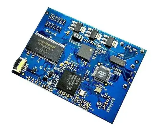

I have a board where in principle aim at emulating a DVD-ROM loading iso file from a drive.
This board is running a ARM CPU with 32MB of ram and has no vga output. The firmware update comes with 2 files called uImage and rootfs that needs to copied into the SDCARD.

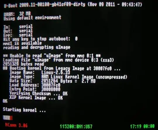

I have seen a post for this device with a screenshot of the boot sequence, so it might be encrypted but not sure.

The picture of the board:

  • Values from mkimage look bogus to me. Could you shared the image? Or give a try with dumpimage? – wisk Apr 16 '19 at 20:24
  • I have added the result of dumpimage in the thread but it shows the same result. You can find the complete SDCard image which contains the boot in version v1.30 here: http://www.mediafire.com/file/5fqybr87uefiled/xkey_110mib_microsd_image_v1_30.7z/file – Armandooooo Apr 17 '19 at 08:59
  • You can also find in the link below the latest firmware in v2.01-4 which is not the complete SD card image but just the update of file uImage and rootfs that are to replace the one in the SD image. https://gbatemp.net/download/x360key-xk3y-firmware.32248/download?version=32248 – Armandooooo Apr 17 '19 at 09:02
  • Thanks for sharing. With OSFMount and Ext2sd, I was able to mount your SD card image. Unfortunately both uImage and rootfs seem to be encrypted (or compressed with an unknown way). Are you sure this is a i.MX SoC behind? Did you disassemble your key to check the reference on the chip? – wisk Apr 17 '19 at 13:14
  • The reference is LPC3143. I have the data sheet here: https://www.google.com/url?sa=t&source=web&rct=j&url=https://www.nxp.com/docs/en/data-sheet/LPC3141_43.pdf&ved=2ahUKEwidg_WG2dfhAhURmRoKHe3SA_cQFjAAegQIBhAB&usg=AOvVaw3FPDTrDh5V1Nk8rvkd2nXF – Armandooooo Apr 17 '19 at 17:57

LPC3143 supports secure boot so probably this device has been configured for it. From the datasheet:
  1. Features
– On the LPC3143 only: secure booting using an AES decryption engine from SPI flash, NAND flash, SD/MMC cards, UART, or USB.
6.7 Internal Static ROM (ISROM)
The internal static ROM is used to store the boot code of the LPC3141/3143. After a reset, the ARM processor will start its code execution from this memory.
The LPC3143 ROM memory has the following features:
  • Supports secure booting from SPI flash, NAND flash, SD/SDHC/MMC cards, UART, and USB (DFU class) interfaces.
  • Supports SHA1 hash checking on the boot image.
  • Supports non-secure boot from UART and USB (DFU class) interfaces during development. Once AES key is programmed in OTP, only secure boot is allowed through UART and USB.
  • Supports secure booting from managed NAND devices such as moviNAND, iNAND, eMMC-NAND and eSD-NAND using SD/MMC boot mode.
  • Contains pre-defined MMU table (16 kB) for simple systems.
If you can get runtime access to the device, you may be able to dump the decrypted data; I don't see a way to decrypt these images statically.

  • Dear Igor, thank you for your answer, what do you mean exactly by "get runtime access to the device"? – Armandooooo Apr 23 '19 at 20:32
  • @Armandooooo e.g. serial console (UART) or JTAG – Igor Skochinsky Apr 24 '19 at 05:42
  • There is a way to get a serial connection to it, but I don't know if it is UART or JTAG or anything else. Do you think doing the following would help progressing: https://www.eurasia.nu/modules.php?op=modload&name=Forums&file=viewtopic&topic=7006&forum=94 – Armandooooo Apr 24 '19 at 09:44
  • @Armandooooo: yes, that looks like a good start – Igor Skochinsky Apr 24 '19 at 10:35
  • Hi Igor, apparently there is no prompt after boot as per the link above. What should i look for then? A way to dump the encryption key? – Armandooooo Apr 25 '19 at 09:05
  • While I am purchasing the necessary parts to get the screen, I have come accross a image to recove the board in case of wrong update, plus the fpga file to reinitialize the lattice fpga. – Armandooooo Apr 26 '19 at 21:51

The MCU on your target PCB is a LPC3143, which was pre-programmed with the "AES-VALID" bit set in OTP at factory.
This means, OTP also holds the bootloader AES key which is a AES-128-CBC crypto key as per the MCU manual. So the bootloader is encrypted. This also applies to the Kernel itself. The Kernel AES key is stored within the bootloader binary once you get the bootloader decrypted (which requires shifting the encrypted bytes as well as the AES key and the AES IV around).
This MCU supports locking the access to the OTP area once the bootloader has started. The developer just has to set the "READ-PROT LOCK" bit after bootup and any reads from that area will then return zeroes (0). This definitely applies to your target.
I've been previously working on the LPC3143 on my own regarding the encryption and hacking open access to the locked OTP area (with success). The effort was big as it requires soldering at least 14 up to 16 wires to the target and some expensive extra hardware as well as Python scripts and an ARM memory dumper written and compiled in C.
But the AES key only won't be enough as LPC3143 encrypted binaries also require the AES IV which is hiding itself within this MCU's BOOTROM.
Regarding your own target, I almost have the whole OTP area dumped as well as the BOOTROM and the bootloader AES key and AES IV extracted as I've been working on the XKEY as well. With UART connected to the PCB you basically only see debug output of the bootloader but not from within the Kernel itself. So how did you get terminal access there as it doesn't print out any messages after decryption and verification of the Kernel header and jumping into SDRAM where it resides?
